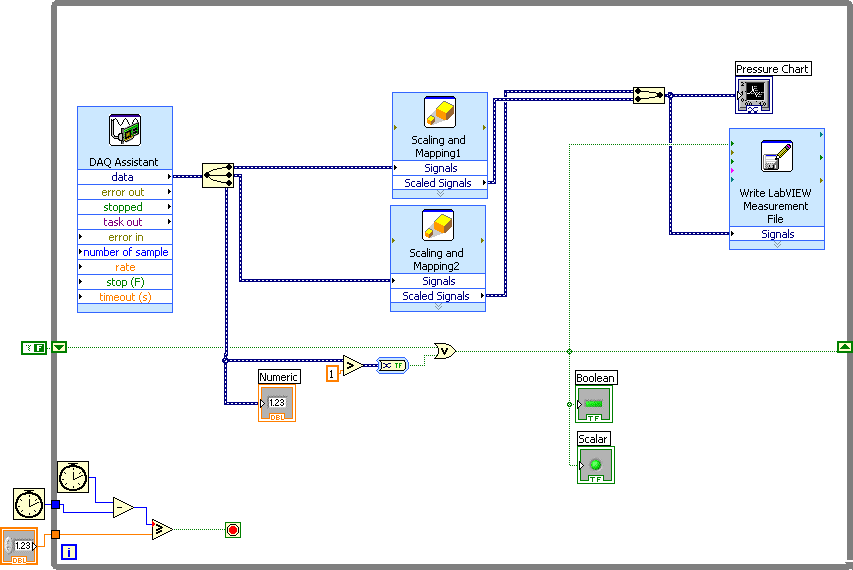

First of all thanks for all your precious advices.I have corrected the problem with dynamic data type. However the code is sitll not performing the desired function. Again I think it would be prudent enough to mention the goal of this program.
This program has to report pressures at 2 different locations through two sensors connected to 2 channels 0 and 1 of a SCXI-1121 module, and simultaneously write data to a file.
Now here's the catch:
When writing data it has to start according to a valve which excites itself to 1V when opened. SO I have a third channel measuring voltage at the valve. The valve gives out voltage > 1 only for a fraction of a second and again shuts of. As soon as this impulse reaches the channel The program should start writing and continue writing till stop button is pressed without concerning itself with the voltage after the impulse. But sadly that is not happening in the program. What's happening is that:
The program starts writing after voltage is greater than 1V and stops as soon as voltage falls down.
Kindly mention the faws i have, which are preventing me from getting to the result
Thanks in advance
Vaib

Try placing the Convert From Dynamic Data where I said to place it. Here's a picture with the correct location and cleaned up.
Message Edited by Dennis Knutson on 06-16-2008 09:17 AM

Thanks for replying. I modified the circuit as mentioned by you. However the DDT is not working properly it is only transfering false to its output node eventhough its input i.e output from the greater than function is true. Kindly suggest a solution Thanks again in advance, for your continued support.

Try converting the Dynamic Data to single scaler before checking the value.

Thanks a lot!! it did work. I had one more question before i wrap this up? I want to measure for how long my data has been written in the file i.e. time elapsed after the first data point was written in my file. Please suggest an appropriate mechanism. Thanks in advance Vaib
