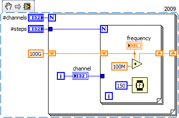

Yes I want to sweep the frequency. I want to sweep by fine tuning the frequency.
the laser has multiple channels, and we can set the Grid Spacing between channels, the default value of Grid is 50GHz, I want to sweep every 0.1GHz,  I don't know if I can set the Grid to that small, so I wanted to use FineTuneFrequency (the maximum of FTF is 6GHz)
for example, choose channel1 first (frequency =100GHz), then fine tune by 0.1GHz, frequency=100.1GHz.  fine tune 0.1 again, frequency=100.2GHz..........loop for 10 times , frequency=101GHz. then jump to channel 2 (frequency of channel2=101GHz), then loop the FTF for 10 times.....then jump to channel3.....
so I want to use for loop to fine tune for 48 times, and jump to a new channel.....maybe the configuration I draw is wrong........could you tell me how to correct it ? Thanks!

Hi cantata,
just a "concept drawing" from your descriptions:

another simple question:
broken wire: the type of the source is 1-D array of VISA session of class, the type of the sink is VISA session of class.
How can I connect them together??? Thanks!

Don't create an array of VISA sessions. Do you have something in a for loop and auto-indexing an output? Don't do that.

I just want to close the VISA session. and in the for loop there is a channel sweep

As Dennis said:
DON'T create an array of VISA references!
If you don't know how to handle the situation until now I suggest going through the LabVIEW basics (free online courses offered by NI) and read the full help on the FOR loop!
(Or use the current LabVIEW version 2014 as it will help in exactly this situation. It was a nice webcast yesterday…)
