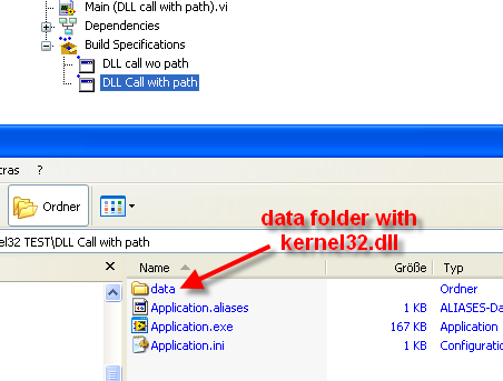

Normally LabVIEW should not make a copy of DLLs from System32 directory to the targed directory in case if kernel32.dll called simply like this:
Then kernel32.dll will be not copied to data folder (was not created in my case):
but if you perform call like this:
Then LabVIEW will make a copy of kernel32.dll in the data folder:
So, you should be sure, that all kernel32.dll calls performed without full path to C:\Windows\System32.
What also may happened - kernel32.dll was "relinked" to data folder, like this:
Of course, this is totally wrong (and then error occurred by build).
Also you can check dependencies list:
Hope it helps a little bit.
 Andrey.
