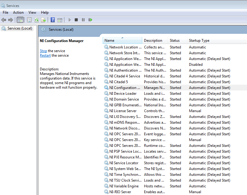

Now I have another problem.
When I turn on my PC cDAQ does not start automatically.
I have to go to Windows services and Start manually NI Configuration manager. Even Start up is set Automatic
Once I run it, cDAQ works correctly.
My company uses McAffe for antivirus
Regards
Edgar
Message 9 of 14
(5,094 Views)
Accepted by topic author EDGAR_PLATRONICS
Regards
Edgar
Mine too.  (McAffe)
it turns out that if you change the service start-up type to "Automatic(Delayed Start)" for NI services McAffe plays nicer.
