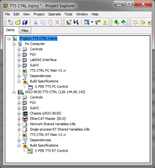

I have a project comprising a RT VI running on a cRIO-9030, and a host VI running on a desktop computer.  The two programs communicate via shared variables which are hosted on the cRIO.  As shown, when I run the VIs from the project, everything works as intended.  When I compile the RT VI into a startup executable and deploy this to the cRIO, along with the shared variable libraries (targeted to the Support folder in the build specification), I am unable to connect to the running real-time executable.
1.xcf
I have "Disable Autodeploy Variables" checked on the cRIO target, so I no longer get the prompt to stop the running application in order to deploy the variables.  The host VI opens and appears to run, but has no connection to the shared variables (data does not update).  Compiling the host VI as an executable and running it outside of the project results in the same behaviour.

It would appear that the error has now been corrected.  There were three things I changed:  the startup.aliases file in the startup directory on the target (home:/lvuser/natinst/bin) had "localhost" set as the alias for the controller.  I changed this to the controller's IP address.  Next, I had some file I/O functions in my RT application which used paths relative to the path obtained with the "Current VI's Path" VI.  As this path changes depending on location / execution system, I had to create a VI which used the Application:Kind property with a case structure to appropriately strip / build the desired data file paths regardless of execution system.  This may have broken my RT application.  Finally, I had a property node in one of my RT SubVIs which attempted to modify an indicator in the SubVI, which is not supported in a compiled RT executable.  I may have done this for debugging purposes somewhere along the way, but in any case, I removed it, and after recompiling and deploying the RT executable, everything seems to be working as intended now.  The host VI on the desktop computer can connect to the RT application through the project, and when compiled into an executable, that works too.
