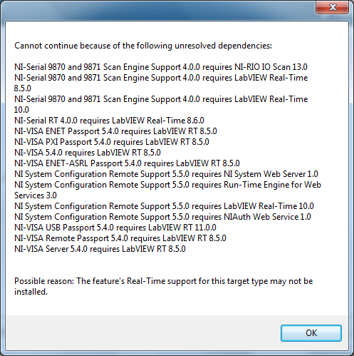

I am getting the errors as attached in files.
Please help me.
(4,482 Views)
Do you need to install those components? If your application does not use them, then there is no reason to install them on the cRIO. If your application does require those components, then you need to install the required modules listed in the error dialog. They are available on your LabVIEW install disks or can be downloaded from the NI website.

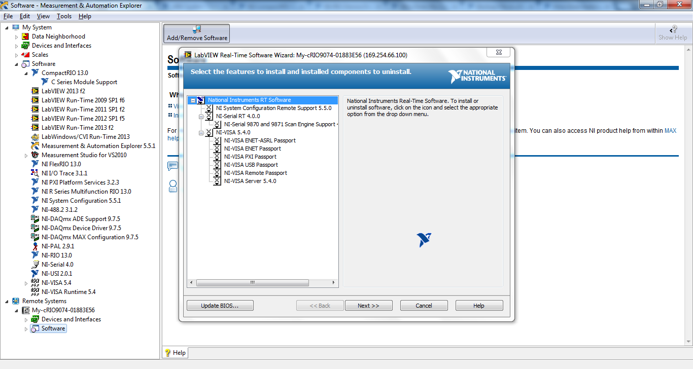

I dont want to install these modules. I want to install the real time target software. i am not able to find that in the wizard. i get only these items in the wizard which i dont want to install. please tell me what i am missing.
(4,427 Views)

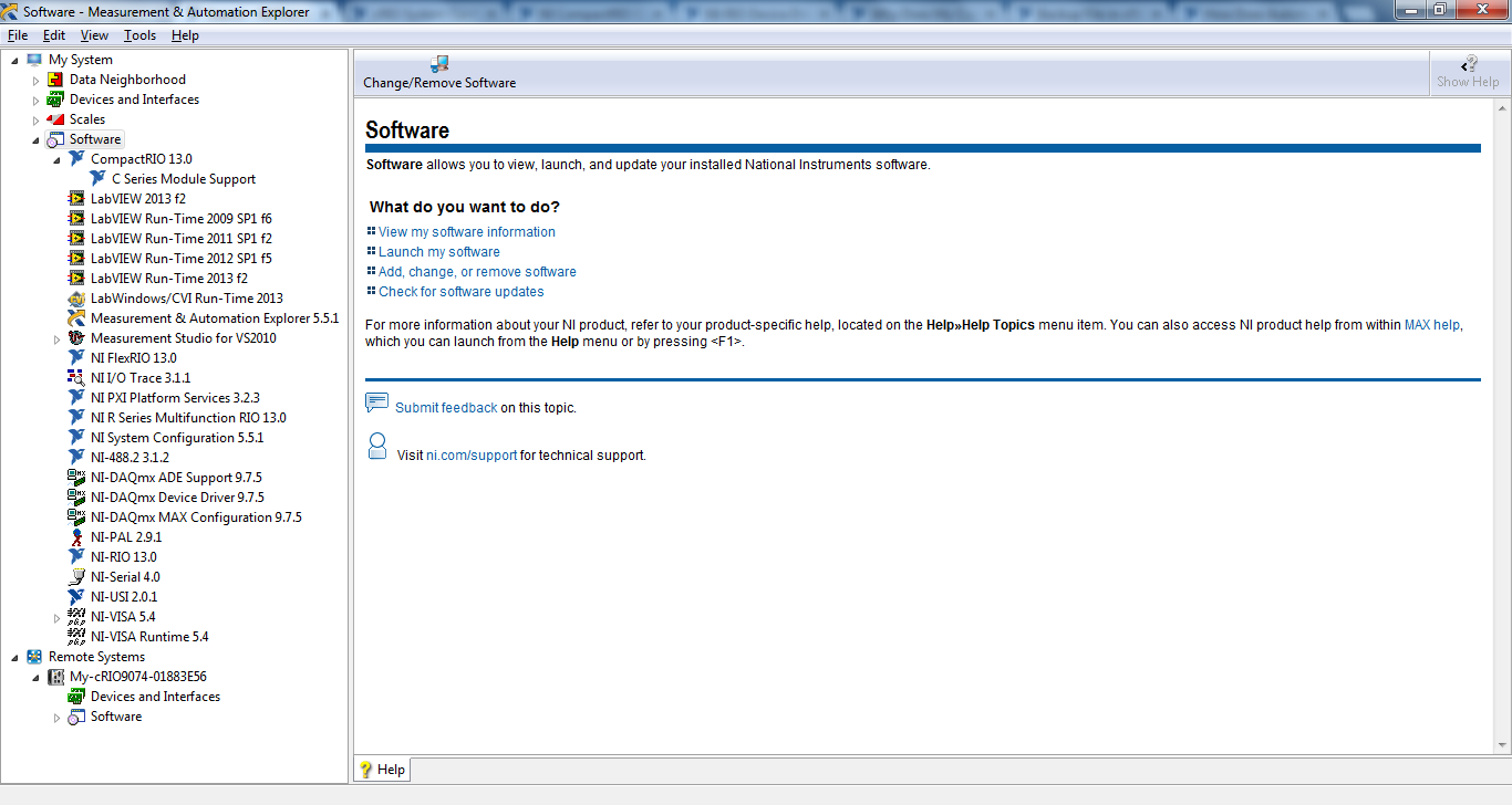

It's a bit hard to tell from your screenshot, but I think you are missing the LabVIEW Real-Time module, which is absolutely required to run LabVIEW software on your cRIO. Is there an arrow next to "LabVIEW 2013 f2" in Measurement and Automation Explorer? I don't see one in your screenshot, but that could just be image resolution. If so, expand it and see if the Real-Time is listed there; if there is no arrow, then you have no LabVIEW toolkits installed. Install the Real-Time module.
(4,416 Views)
Thanks for the support guys.
Its my mistake i haven't installed labview real time module. i have installed it and now it is working perfectly fine.
