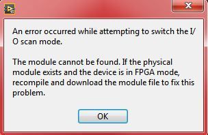

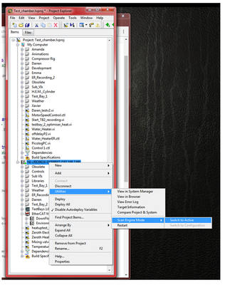

The scan engine is stuck in config and I have to switch it to active.
 This is the error message I am getting.

Make sure you are connected correctly with the cRIO.
Also check that the module is inserted appropriately, is it recognized by MAX?
Try the suggestion in the error message: recompile and download the module file.
