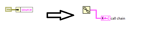

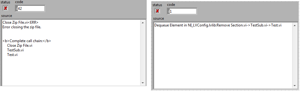

I have stumbeld into a problem where I need to extract call chain from error clusters that are generated by labview VIs and native functions.
Here is example of 2 completely different results:
Source by definition should mean origin of error, why sometimes I see error description added into it if it can be extracted by error code??
If other strings are added how can one separate call chain from other informations ?
I could not find documentation how this string is generated and how to format source string back to call chain that will work in all cases.

Hi Pawhan11,
I don't believe you can guarantee that every error cluster has the call chain on it, but if you are the one defining the errors, you can use the function "Error Cluster from Error Code VI". This has a boolean input for show call chain which you will want to set to true. In this case, source does not refer to a place of origin, but the thing which caused the error; both are valid definitions.

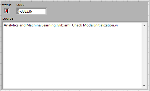

The reason I am asking for this is that I want to have EH that will better fit to my needs, since many error coses appear in other external drivers and then it is a mess with error cluster. I have defined simple Error class on top of error cluster that allows me to add custom errors without necessity to pay attention to error codes since errors are device/module specific. When I add error myself I know for sure what was the call chain. When LV creates error it is unclear how this call chain is inserted into source... and that is the only thing that I am missing to convert error from labview error cluster into my error class.
I am trying with random NI vis and I can not see clear pattern of what content is to be expected (in this case no call chain only vi name inside vilib):

That one will have a description in <LabVIEW>\resource\errors\English\Analytics and Machine Learning-errors.txt or within <Program Files>\National Instruments\Shared\Errors\
Those are the two locations that are used to hold xxx-errors.txt files when you use tools>>Advanced>>Edit Error Codes...

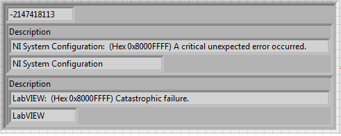

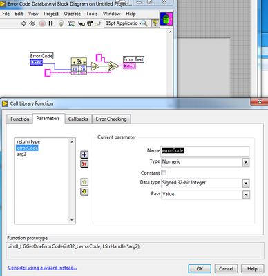

Interesting, in general error handling we have ErrorCodaDatabase vi that calls dll that gets error code description based on error code. If NI decided to have the same error codes in for example say 2 groups how this function determines which one to get based only on error code?
For example this error code from LV exists within 2 families:
They mean more or less the same so that is not a big problem
Message 8 of 10
(7,611 Views)
Explain errors shows both

How Can I use this feature programatically? The only reference I could find was:
https://forums.ni.com/t5/LabVIEW/Possible-to-return-the-quot-Explain-Error-quot-string/td-p/2227456
It refferences to general error handler which is based on getting error description based on error code.
