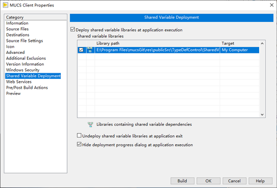

I use type define control as network variable, but after building application, it prompts dialog saying that can't find the control when execute application.But if ignore all of them, the application works well and the controls are all works at window.So how to disappear the dialog?

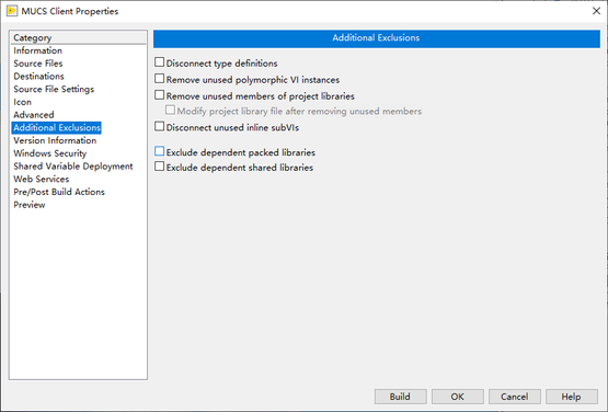

Make sure type defs are not disconnected:
If that doesn't work, I'd make sure the type def is used in the executable, simply by putting it in a diagram, or maybe even a front panel (a the diagram constant might be removed by dead code removal).

In fact, I used the type def in the front panel, and binding with network variable.And if I checked disconnect type defs, the actor core.vi is broken.
