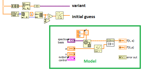

  • Your initial parameters are in the range of "almost -inf" to e^2, A more reasonable choice would be the natural log of an even distribution that sums to 1.
  • You model is a simple Matrix x Vector multiplication, so create the matrix as variant and do the model as in the picture. No loop needed!

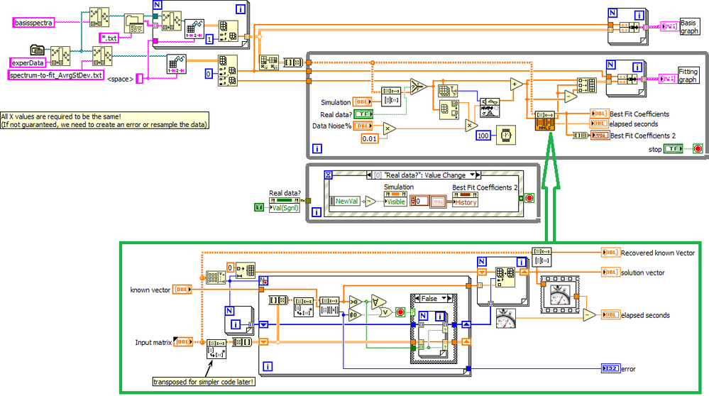

OK, here's my fast code (LabVIEW 2016). See if it works for you...
For simplicity, it reads the file in a path relative to the VI. You can easily change that.
Solution takes about 300ns (compared to 100ms for your code), or about 300x faster.

thanks a lot for your code, it's truly fantastic and so fast. Considering that in several cases i have up to 150.000 curves to be automatically fitted, the high speed of your code is so helpful!!! And besides the high speed, the fitting results look perfect.
