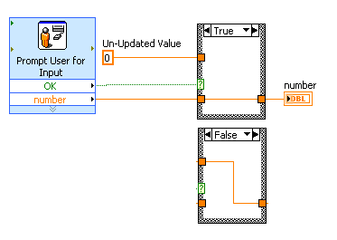

You could try doing something like in the image below.  You can either pass the unchanged number into the case structure or make it an "NaN" to denote the prompt was canceled.

The Express VI still spits out a value since that's what the user entered. It's up to you to look at the "OK" output and update your front panel indicator only if this value is true.
