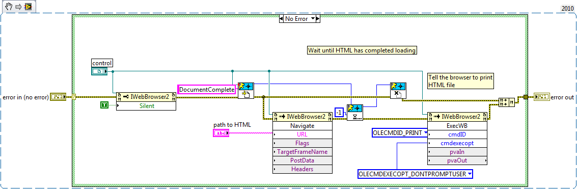

The solution is to use ActiveX to print the JPEG image and not the HTML Report Print Function.
ActiveX prompts the user to choose a printer, like printing from any other program.
I attach a working vi and here is a snapshot of the code that was missing.
Message 21 of 22
(1,113 Views)

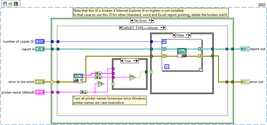

can i send the printer name without using a dialog??
