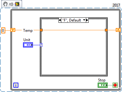

Your case statement should be within a While loop. Your output value should be a wire that run throughs the case statement and into a shift register on the while loop. Basic case.png
