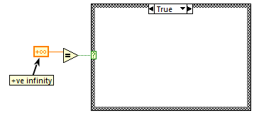

There is no value assigned in integer which represents "Infinity".
So i understand that you deal with floating point numbers. A simple "Equal" compare of your number to "Inf" will result in data you can use with a case structure....

You'll have to use a Equal to Inf and have True and False cases. You can't wire a double directly to a case structure for this.

Pictures paint a thousand words!
