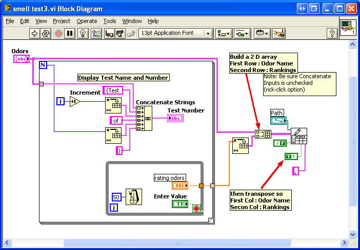

Dear Hueter,
Thank you so much for your great work! your program is lot more efficient than mine. I have made some slight changes in your program just for my work purpose. I just have one more question: is there any way I can use LabVIEW to put Smell 1, smell 2, smell 3, smell 4, smell 5 in one row and the numbers acquired in the second row. I have added True constant to put the data in a row in the exl sheet. However, all the smell numbers and data are in one row instead of two. I have dragged the acquired numbers to the the second row. therefore the variable coresponding to the smell are side by side. I was wondering if LabVIEW can automatically send the smell types in one row, and the numbers in the other. If you just run the attached VI and see the collected data in the exl spreadsheet,  i think you will be more clear what I want to know.
Samia
Message 13 of 20
(3,568 Views)
By adding the True constant to the transpose input, you changed the example that was posted. The example that was posted placed the smell names in one row and the values in another row. Undo your changes.
Message 14 of 20
(3,565 Views)
Accepted by topic author alams
Check it out...
Message 15 of 20
(3,561 Views)
Sorry, I meant putting the smell numbers in one COLUMN, and the variables in anothe COLUMN.
having them in two rows is pretty messy and there is a higher chance of making mistake while analyzing.
