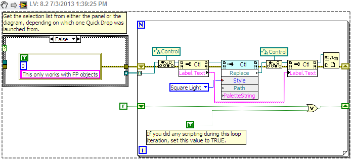

Here's a Quick Drop plugin that'll do what you describe.  Change the style constant in the For loop to change what it replaces the selected objects with.
This VI is in LabVIEW 2012 and was not made pretty. 🙂
Jim
(2,830 Views)
Sorry, I'm just now seeing this thread. You probably didn't need to write a custom scripting VI to do this... there is a built-in Quick Drop Keyboard Shortcut in LabVIEW 2010 and later that will perform a replace of one or more selected objects. So you could select the round LEDs, press Ctrl-Space, type "Square LED", and press Ctrl-P. That will replace all of the selected objects with the object type you specified in the Quick Drop text box.
