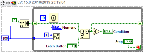

Something like this might do what I think you want:
Here a circular buffer of initially "false" values is passed to Replace Array Subset with the pointer to the index moving around (Remainder when divided by 100). I use Or Array Elements to find out if in the last 100 iterations, the button has been true. Since it latches, it is true just once, but the output is true for the following 99 iterations.

Minor critique/question about cbutcher's suggestion (and RTSLVU's signature).  I believe that the OP wants exactly 100 reads when the "Read 100" button is pressed.  I suspect that the suggested code gives at least 100 reads (consider a second button push while the 100 reads are taking place).
Who said "State Machine"?  [I'm guessing GerdW or RavensFan ...].

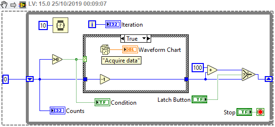

If the desired response is to increase the number of samples to take by 100 each time the button is clicked (and not to measure the next 100 samples, regardless of when the previous button was clicked) then perhaps the following is a better option:
Of course, effectively this is a 2 state State Machine...
If instead, the user wishes to prevent button clicks during an acquisition, then the button should be disabled using a property node (perhaps a Case Structure with the Latch Button as a selector).
