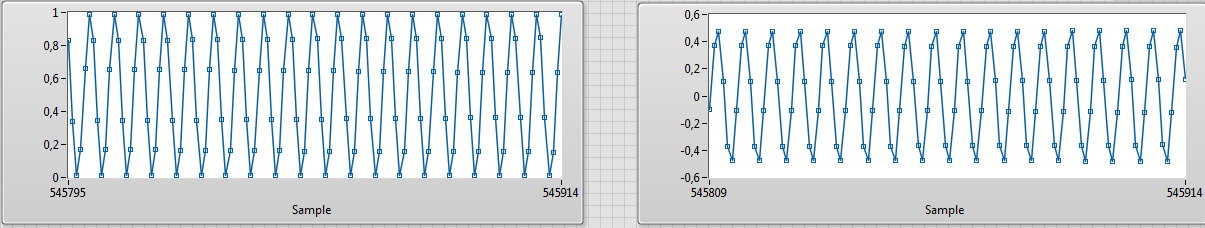

My test is a simulated lock in without noise. I generate a sine with a certain frequency. This sine is multiplied with the cosine and sine of the same frequency and therefor demodulated. The DC of the product of the two sines is 0,5 and the DC of the sine cosine product is around zero. Both signals also containing double the frequency from the beginning. I think a picture is easier, left the sine*sine and right the sine*cosine:
The values are in the I24.1 format.

Ok, the worst case is just maximum input all the time...so inserting a sine is not maximum all the time...I can now confirm the bit growth formula. If the bit length is longer than allowed, the filter output is nonsense!
