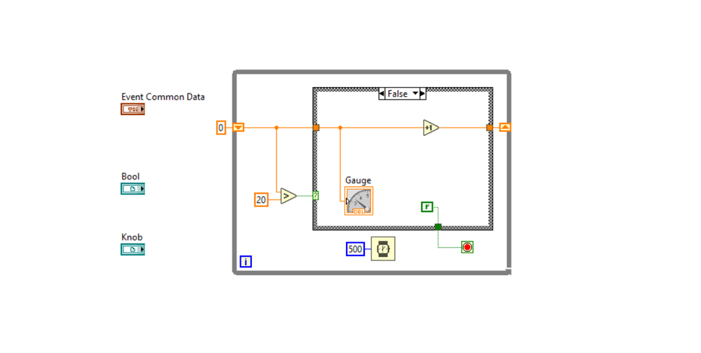

So the first callback is pretty simple, will run 10 seconds and do nothing as below, image.png

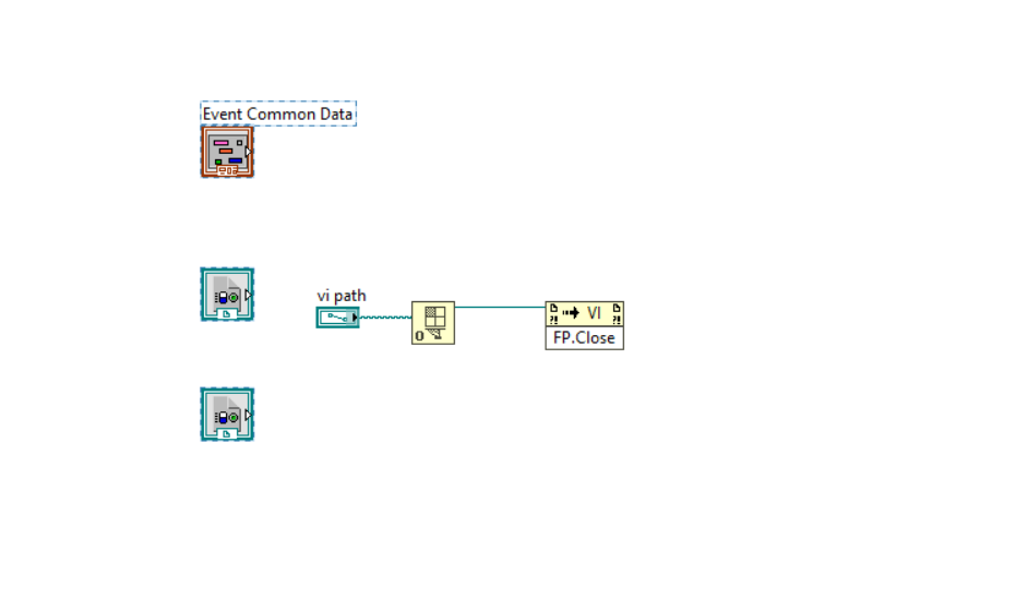

in the second callback,the only thing i did is trying to close the first call back. but of course failed.

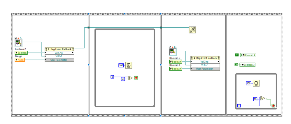

and below is the main code

AFAIK, Waiting in callback events will ruin all event handling for the rest of the application. Those callback VIs are prioritised pretty aggressively.... I wouldn't recomment it.
Message 4 of 9
(3,914 Views)
that's good to know, right now i don't have any other idea except a callback to realize this functionality, another solution is use a Global variable, which i think it's also not recommended to use?
Message 5 of 9
(3,865 Views)
You can make the callback event trigger a user event or value change event. Then handle the event in a normal event structure.
Most of my callback events get refactored pretty fast. For .NET and AX events, callbacks are the only way, so they are exceptions.
LabVIEW Callback Events have some rusty edges. They are not 100% stable, especially when created in clones (multiple levels) and register events on subpanels (multiple levels) in clones. And the lock classes that have callback VIs, and you need to reload the project to continue development.
I usually dynamically start a clone VI with an event structure. With the right VI server settings, this VI will stop if the creator stops. This has several advantages. You have a normal VI handling all events. And it won't crash or hang LabVIEW. And it won't lock your classes with callbacks ("running in another context"). It's a bit easier to comprehend as well. A bit more work to setup though.
