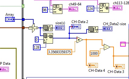

OK, this works pretty well:
Any suggestions on how to convert the CH-Data 2 to two's compliment before I multiply the 3.35693359375?
thanks again
Try changing the representation of the indicator to I16 😄
The wire already is I16.
Message 12 of 13
(1,231 Views)
Wyhy are you using an I16 array control instead of a diagram constant? Since the data is not used and no user iteraction ever takes place with this array, it should not be polluting the front panel.
Right click the array terminal and .. change to constant.
