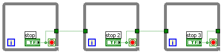

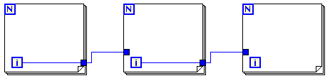

An example of what Dennis and gwd are describing:
[edit] Reading comprehension is HARD.  Here is an example with for loops.

You can still use the dataflow. If you generate data in a for-loop you want to write to a DAQmx write vi, you just can wire them. As jasonhill did in his examples.
