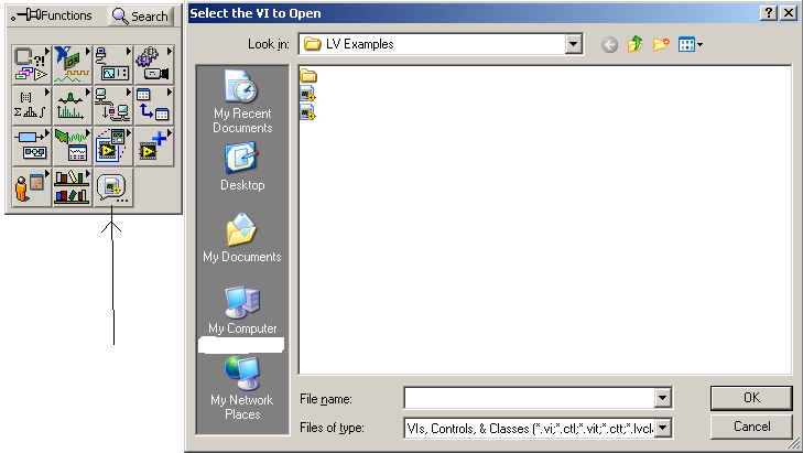

Do you mean how to place it within a block diagram?
If so, there are 2 ways:  1 (simplest?) open the VI you attached below.  Have the destination block diagram opened.  Use the mouse cursor and click on the connector pane (icon of this vi) and drag it into the destination block diagram.
2. (more comprehensive) :  From your block diagram, in the Functions Palette, click on "Select a VI".  Browse and select your vi.  It will place it one your block diagram.
