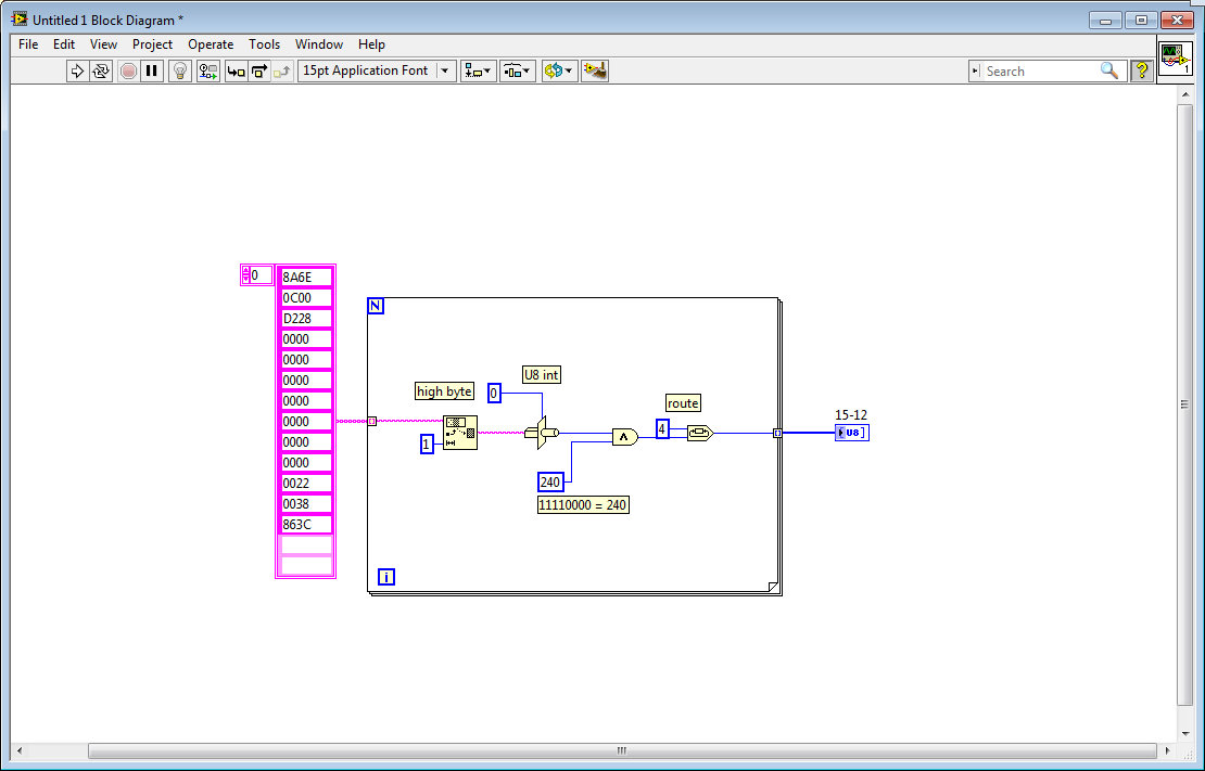

Here's how to convert the 4 MSB to a numeric. (for other bits, you might need to add a mask (logical AND with xF, for example)

Hi, ebuckbuck,
I know what you need through your code, for the highest bits, here has a simple way to turn it into decimal, I think it is much more difficult for the customized 4 bits.
