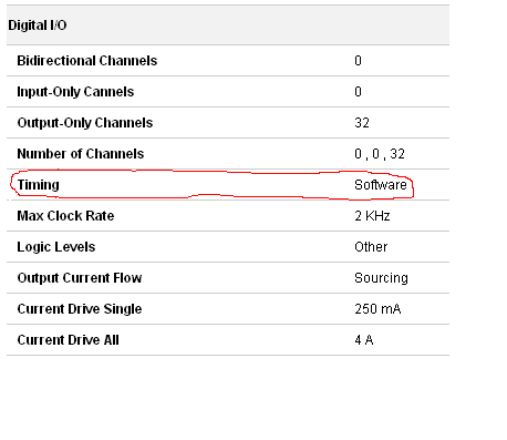

 Your error message would imply that you are trying to use hardware timing.  Are you?
When your error message says that the device does not support buffered operations, it means exactly that.  You are trying to do something that the device is incapable of.  If you look at your spec sheet, you'll note that it specifies software timing.
You will need to either use software timing, or you will need a different device.  Note that the maximum clock rate for your software timing is 2kHz, so you will not be able to go faster than that.  Of course, achieving 2kHz with software timing is pretty unlikely anyway.
