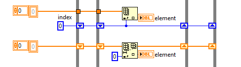

So auto indexing is probably of.
So as GerdW mentioned, some shift registers are most likely required.
Instead of keeping the index in a shift registers, retrieving the element from a non-autoindexing array, you can also delete elements from the array that 'lives' in the shift registers.
(Arguably) a simpler concept. Sometimes convenient, but less efficient in most cases.Indexing in Nested Loops.PNG
