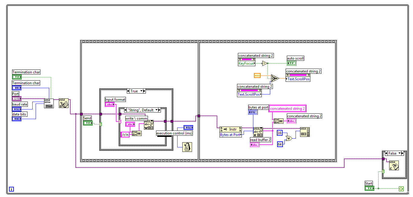

here's a snapshot of my block diagram

Accepted by topic author nicco
Don't open and close the VISA session inside the while-loop.
Does the respond from your device have any Termination charactor ? If yes, use that and NOT the Bytes at port

Next time, please post your VI instead of a picture, especially when you have case structures with invisible states.
Several things come to mind:
First the good part. There's nothing wrong with using the Bytes at serial port function to know when something's there to read if you don't have a termination character (the serial communication for our instruments actually uses two characters for termination because of our particular circumstances, so we have to use BaSP also).
Now the other stuff.
You are opening and closing the serial connection every time you read something. Just open it initially and close it after the loop is done. It's wasting a lot of effort, not to say time.
It's a lot easier to concatenate an ongoing string by using a shift register than a local variable (I think that's what you have, it's kind of small for me to see).
Get rid of the sequence structure. You have your actions connected by wires (although most of us would advise also connecting them with error cluster wires, so you can know what went wrong if it did), and that will enforce the sequence of actions through dataflow.
The property node stuff in the second sequence frame doesn't make much sense to me (but maybe that's just me), and it also is not synchronized to the indicator it's involved with, so there's a big possibility that it's not doing what you want it to.
Do you realize that you pass the number "80" as your mask in the VISA Flush? (Stick an indicator in there and check it out.) That is not a number it knows what to do with. Why are you flushing anyway?

Data are spoiled because you flush everything you receive between bytes at port and flush buffer. Sometimes it is nothing and you get data you expect.
Reading removes read bytes from the buffer, you do not need to flush it.
