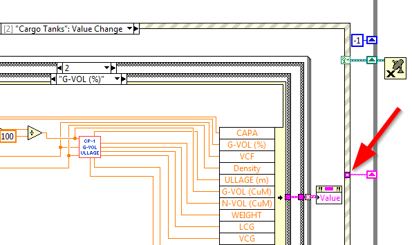

I'm struggling to follow what's supposed to happen, but one thing stands out to me.  Is this tunnel coming out of the Event structure causing a problem?

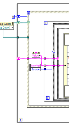

I dont know if i am missing somthing but you are using autoindexing for loop so every element in array is going to change their value and this is what happaning.
you need to get index at which value is changed and update  values at that index only not the whole array.

Try replacing the "New value " with propert node
That won't do anything.  In fact, that is horrible advice.  Using property nodes to get/set values is HORRIBLE.  The property node makes it SOOOOOOOOOOOOOOOOOO much slower than a local variable would and you still have the issues of race conditions with both the local variable and property node.
The NewValue gives the latest value of the control.  That is exactly what the OP needs to use.
