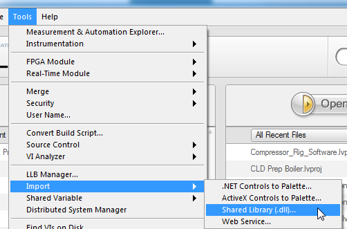

Even though you didn't include the DLL, I'm guessing that they provided one for you? If that's the case, you can use the Call Library Function node in LabVIEW to call the functions as specified in the header (.h) file - you might even be able to use the header file and DLL with the 'import shared library':

Hi Sam
I creat this project with the dll and h files.
But seems before create I need to add some information to the commands as the bumber o chanel (Isuppose it is 1) because i only have 1 relay.
Other thing is the Device name mine is AHFV6
See the other picture from control panel, it appears when I conect the usb cable
