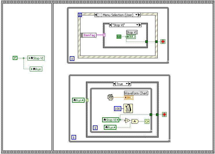

I am using following method for my VI:
In this the lower while loop has the state machine instead of the "inner while loop".I want to know how I can implement "pause" & "resume" features in this. Is there any way to make it more efficient by using dynamic events, queues etc. coz I can see most of the producer-consumer examples are based on these approaches.I am new to LV so I exactly dont know how can I apply those things here.
Message 7 of 14
(4,867 Views)
One more problem that I encountered while using the above method is that the consumer loop has to be executed only once in order to execute the test state machine.For doing this, I am using "run" variable value to stop the main loop of consumer.By doing so the vi becomes unresponsive to the "run" menu item after single execution of the test and thus I have to stop the vi and re run it for running the test for the 2nd time. Any suggestions to solve this problem??

You do not use the producer/consumer architecture. You are using a simple two loop architectures which is using local variables for data transfer.
You should rework your VI to match a real producer/consumer.
