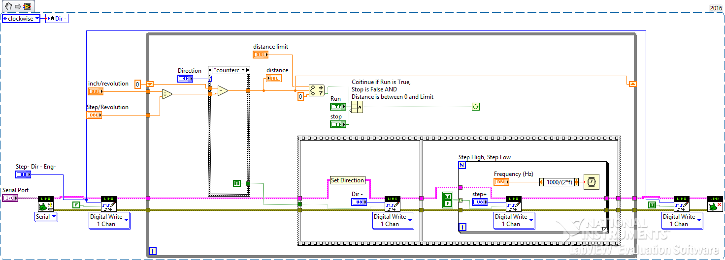

I've done this sort of thing with LabVIEW, arduino and a stepper motor.
I would recommend that instead of using PWM to control the frequency, you just use a digital output pin (like you are doing for the "Dir") and then:
  1. set pin value to HIGH
  2. wait n milliseconds.
  3. set pin value to LOW
  4. wait n milliseconds.
The frequency of the pulse cycle will be approximately 1000/(2n).  You can then set the value of n using a control or a calculation.
The attached snippet shows how I would do this in the 'clockwise' case. Ideally, I would break this out so that clockwise and counterclockwise use the same code to do the step High, step Low, and differ only in the direction bit.... but since your code is working, I don't want to disrupt it too much.

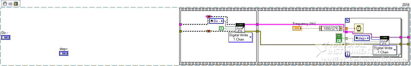

Just for fun, I took a stab at rewriting the whole thing.
I removed the redundant code and the local variables. I hope this looks simpler.
 If it were me, I'd also take out the sequence structure because it just takes up space and the wires between Set Direction and Step High, Step Low ensure that these will operate in the correct order. I left it in because I thought it makes it a little more readable to separate these two.
