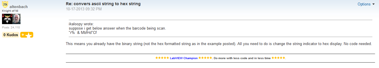

is it still not making sense. im confuse the binary form in math with this form as u said it is binary string already.
What you don't have is a "binary string".  A binary string would be a bunch of 1's and 0's.  I don't know why you'd say "you (that is a complete word) said it is a binary string already".  Altenbach never, ever said "binary string".

Okay. So altenbach did use the phrase "binary string".  But I'd argue that isn't exactly the correct phrasing.  I'd call it a string of binary data.  He means it in the sense of a series of bytes, already in a string data type, that is already "binary data".  It is the difference between having a value such as 255 decimal being saved as a single byte, and would show up as FF, as opposed to showing up as 3 characters "2" "5" "5" (a decimal string), or 2 characters "F" "F", (a hexadecimal string), or 8 characters, all "1", (a binary string).
As you can see, sometimes the terminology can be confusing, and when values are written out in a message, is hard to tell what is the underlying data (is 255 the value of a single byte, or is 255 a value that is being shown as 3 bytes).
Until you can adequately explain what you are trying to do, with examples that actually have anything to do with each other, we can't help.

In this context, It is a string that may also contain unprintable characters. It is a raw string where all 256 possible bytes can occur. (Nothing to do with a "binary formatted" string).
