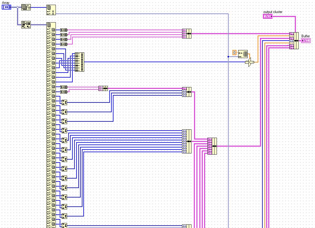

Hi, everybody!
It's true that I didn't try the For loop.
I didn't find a good way to make the universal function ArrayOfClusters-->ClusterOfArray. Everything I tried stops on the "ArrayToCluster" function and the nessecity to change the cluster size (RMB -> Cluster Size...). But I solved my problem and did it that way:
1. All packets I receive I store in a buffer (2D array of U8).
2. Then I transpose the buffer.
3. Get all rows with  "Index Array" and gather them the way I need (making DBLs, Chars and so on...).
4. After all I make the cluster of arrays.
Everything I wrote looks like this:
It's awful, but works good.

Idea wrote:
Hi, everybody! Glad you read the post!
There is the cluster in the attachment. The application I make is a TCP client. The cluster is a message. Actually I get a string, find edges ("DIAG" - begin, "GAID" - end) and then I use "unflattern to string" for making the cluster. I cann't make another structure of the message - I didn't make the server. My client has a buffer of recieved messages. I need to plot graphs of different cluster elements for all messages in my buffer (for example the Time 1 element). If I use the for loop it would be too slow. The idea was to convert all buffer to a 2D array of U8 and then use type cast to get the cluster of arrays. Then it would be easy to take ane cluster element and send it to graph.
I didn't sucseed yet.
Idea.
What is your question about?
A) convert the string you get from I don't know where to the giant cluster, the red part in your message, or
B) making a graph out of some element from that giant cluster, who now is in an array, the blue part in your message.
The code you showed us looks a solution for question A but no loop is needed for this. So why bother about a loop that would be too slow here?
Also your code start from an array of U8, so where's the string?
If you could provide a string that needs conversion, we could try another way ... ...
Question B can easily be solved with a for loop and "unbundle by name". Don't know where you get the idea that a loop would be too slow 😞
Open G library has a lot of VI's to retrieve specific elements from clusters, maybe one of those could help solve the problem.
