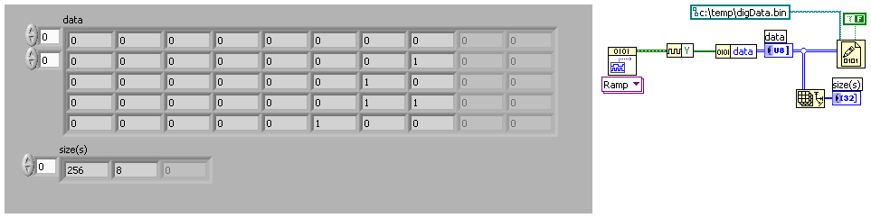

The extra "8" is being caused by the fact that the "Write to Binary File" VI has a "prepend array or string size" input. Its default is true, and in your case you have it unwired, so you get the array size prepended. As for the rest of your issue, what are your Matlab commands to read a file? The following example VI, which generates a digital waveform and saves it to file,
can be correctly read into Matlab using the following commands:
fid = fopen('c:\temp\digData.bin','r');
F=fread(fid, [256,8], 'uchar');
Message Edited by smercurio_fc on 01-18-2008 05:26 PM
Message 3 of 11
(15,931 Views)
Nix that. I just noticed a problem. Checking...
Message 4 of 11
(15,928 Views)
OK. The issue was with the Matlab commands, in that fread fills in by columns. The correct Matlab commands are:
F=fread(fid, [8,256], 'uchar');
A=F';
The array "A" should then look the same as the 2D array in LabVIEW.
