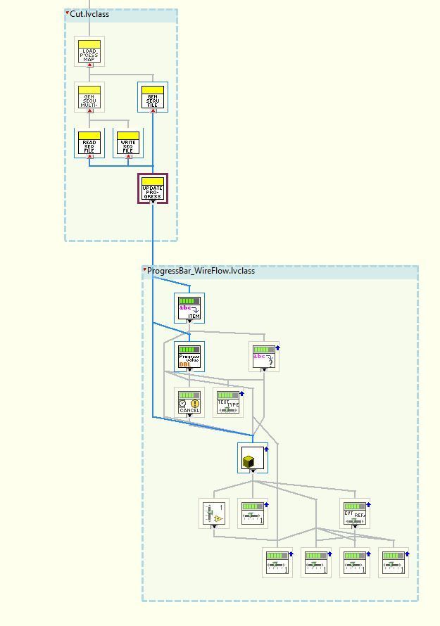

In hierarchy view I see this:
How do I edit my project such that when I move to another PC, it doesn't fall over asking for the progress bar VIs ?

If your dependencies are relatively narrow (i.e. just one class) then open the class and Save As to make a copy inside your project directory.
Then, go to the calling VI (looks like "Update Pro-gress" icon)  and change the VIs that it calls so that they don't call the vi.lib / instr.lib copy anymore, and instead call the new copy.

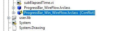

If I save the 2 progress bar Classes to Project, then right-click every progess bar VI and replace with the same from within the Project, I end up with a conflict between the library copy and the project copy.
Dependencies View:
Project View:
Resolve Conflict View:
How do I get the Project to completely forget about the Library copy, and resolve the conflict?  This technique is usually okay when classes are not involved.  What is required?
