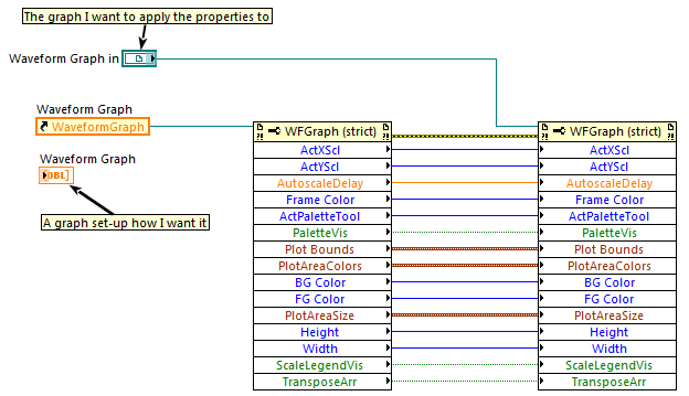

I would do something like this:
There's a waveform graph on the front panel of the SubVI which has been configured/styled appropriately, you can drag the property node down to select which properties you want to apply to the new graph (you probably wouldn't want to write the history if you were just 'styling' a graph, for example - so writing *all* properties isn't appropriate in most cases).
The other option is to create a copy of the waveform graph in the development environment, either by copy+paste or using scripting, it will inherit the properties of the original.
