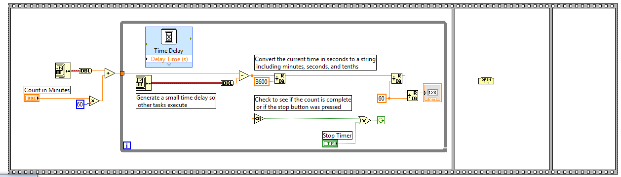

i tried this with what you guys suggested
but i didnt get the state machine to work as smoothly.
can you sugguest a fix?
*it doesnt reset back to 10 after 1st loop
*the sound doesnt go on after 2nd times around

I don't have LV2014 so I'm just guessing here.
If you use the Elapsed Time express vi you need to connect the time has elapsed output to a shift register on the while loop (and also to the loop conditional terminal). Initialize the shift register with a TRUE constant and feed it to the reset input of the Elapsed Time express vi.

In addition to what the others have said, get out of the habit of using the Sequence Structure.  Nothing in your code remotely required it.  Learn what data flow is and how to use it to control your code.

There is no difference between this vi and the previous version. You have just unbundle the status boolean from the error cluster which is useless in this case, keep the error cluster connected to the or gate. You didn't add a shift register as I suggested on the elapsed time fonction. You should use the elapsed time fonction for the countdown also and add a while loop around it instead of using the state machine loop. The countdown should be resetted when you enter the countdown state. I also suggest you add a stop state.

there isnt'
i just saved it as 2010 so someone can view it.
sorry,
you said you werent able to view it so you were guessing what my code would be.
but ill try reading over your sugguestion and make corrections
