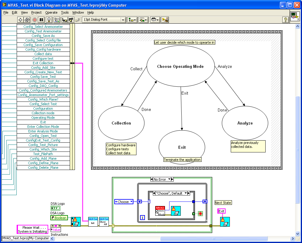

I beg to differ but I break the "code beauty" rule on a regular basis and I do so using control refnums. This image is typical of what my top-level VIs look like.
In the early days of LV when we only had (bearskins and stone knives) attribute nodes (look like property nodes but can only be used in the VI where the control lived) we had no choice and all interaction with the GUI had to be done in the top level VIs.
Those things were a mess since all fo the code had to be in the top-level VI. If your app did something complicated well the diagram looked like it.
But Control references have relieved us of that restriction and we can now write top-level VIs that look like top-level ideas like what mode are we in? etc.
The image I showed above is part of an album you can find here. Under each of those images (I invite you to view for yourself) you will find a link to where I first used those images in other threads. Those threads have a lot of words to further explain techniques for developing easy to read code.  But before you chase down the original thread links review those images and ask yourself "Can I get an idea of what Ben was doing?" If so plese read on. If not forget I ever posted.

Hello Ben,
I'm quite young, and have less experience than you. That is a certain advanntage : my little brain is open to each method, and I often test new methods to build my own opinion.
A strict type def cluster that contains dozen of references is not reusable, so your code is dedicaced for one application, and it seems to be hard to use it in an other project.
I began to work with LV 8.0, and now when I see the Actor Framework, I keep in my mind that Labview continues to be more and more powerfull, and I have to keep an eye opened on theses "new" features not to stay in my little world where "I was the best coder a long time ago, but I never look around to improve my coding methods...
I don't say that you're a dinosaur, and that you're doing wrong ! I just proposed a (my) method to try to have a clean code, even if I now that the word clean depends on what you seek : perfect BD with no cross wires, or optimised code which goes faster that superman... 🙂
