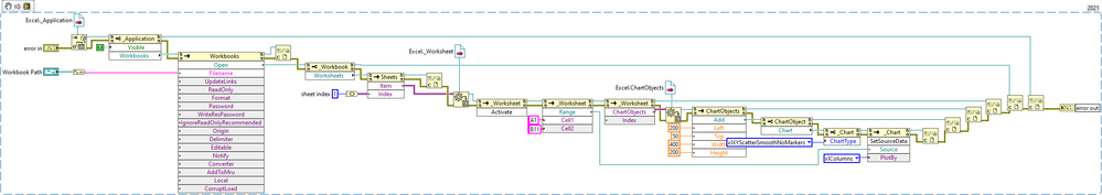

This can be done with ActiveX as was already specified. It's a bit tricky but if you have the report generation toolkit you can skip the first part to open Excel and get the reference to the worksheet. The attached vi shows you how it can be done, I leave you the part to save the file and close Excel after adding the chart.
Ben

Very nice!  I thought it would be at least twice as much code but this is not bad at all.  I code in C#/.NET too, so it wouldn't hurt me to dive in and learn some of this.
Kudos for you!

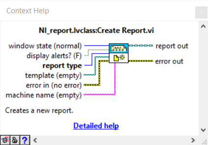

There is an apparently little-known input to the "Create Report" function in the RGT.
@Nyquist noted "you can create a graph with the report generator toolkit, but there are no functions in the toolkit to open an existing .xlsx file, add the graph, and then save it with the graph."
 If you look at the inputs to Create Report, the fourth left input, "template (empty)" is described as
template (Report Generation Toolkit) specifies a path to a Word document or Excel worksheet that acts as a report template. Enter the path to an existing Word document or Excel worksheet to open and edit an existing report for a template. The VI ignores this input for HTML reports.
A decade ago, I posted a "Revised Generate Excel Report Example" on this Forum (you can find it by searching this Forum -- it should pop up before you finish typing "Excel").  It shows how to make the Data Plot in Excel (try it!).  I wasn't using Templates back then, but I do use them now.
There are functions in the RGT that can let you handle multiple WorkSheets.  If you have an Excel Workbook whose first WorkSheet has data, you can help yourself by designing the input Excel Workbook/Worksheet such that the data are in a "known place".  You do not necessarily need to know how many rows have data (there is a function that helps you find the end of the data).
