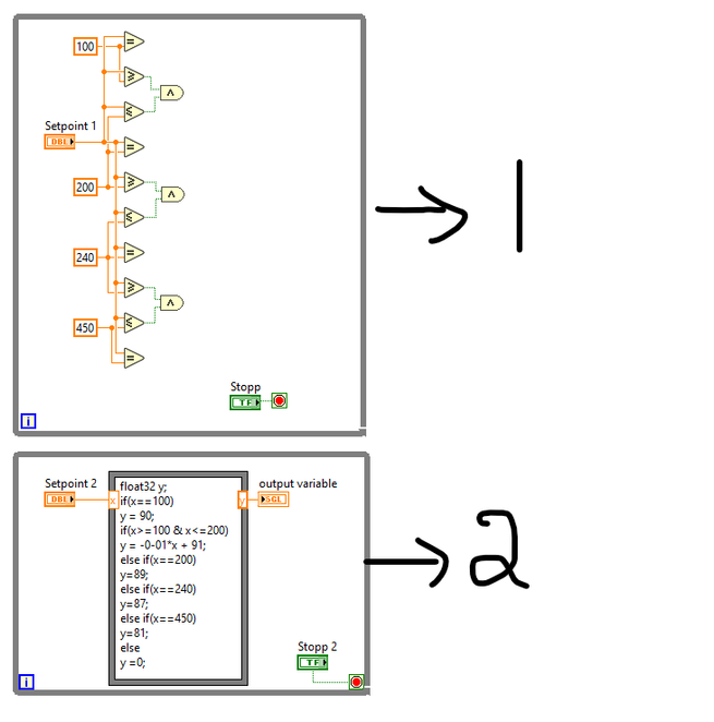

create case structure using mutilple boolean conditions

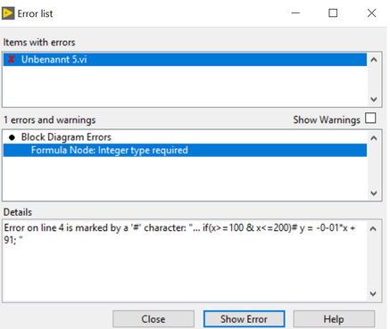

1. Is it possible to build enum type of control using boolean conditions and then connect it to a case structure?
2. I got it partially working using a formula node (only when the second condition is removed, i.e., x>=100 & x<=200), but when it is present I am getting an error.
Edit: y = -0-01*x+91; y = -0.01*x + 91;

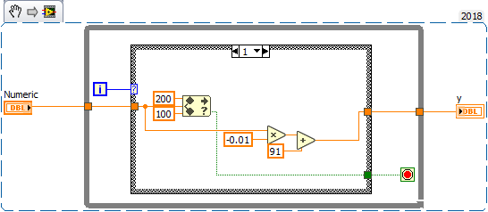

Since the 2nd solution basically loops/checks through your comparisons until one is found, i'd make a while loop with a case structure that does the same. (Case 0 is the 1st X=100 case and so on)
(I Think you must use 'AND' in your formula node, '&' is a bitwise AND i Think, thus the integer requirement)

You have 2 solutions for X=100, which one is correct?
Qestit Systems
Certified-LabVIEW-Developer

Since you used a Double for X, i assumed you'd have values as 100.12. In that case, the case selectors option of 100..200 isn't really an option. 🙂 That only works for integers.
Qestit Systems
