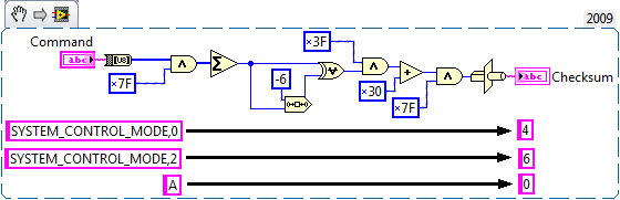

This seems to work:
A really big hint is that when you are sending '0' or '2' or '4' to the instrument you are sending the ascii values, not literal values.  A second hint is having a few ascii -> character mappings in your head (such as 0,a,A) is often useful.
