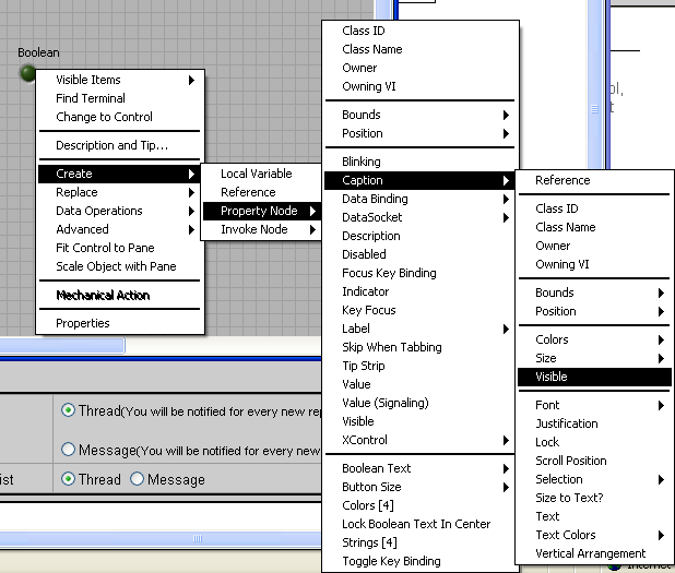

I have LV 8.2.  I can create a property node for caption visible and for label visible.

Hi Lynn,
I didn't mean to make it sound like you weren't aware of those property nodes.  By your bars, I know you are an experienced LV programmer.  Sometimes there are so many options on those create node menus that you don't see all the choices that are there.
I went through the steps you listed and I did get that error number 1320.  I just let it pop up a dialog box and got this text. " Error 1320 occurred at Property Node (arg 1) in Untitled 1.vi
LabVIEW:  In run mode, LabVIEW cannot get or set a property for a control part that has not been created."
Could this be considered a bug?  Why would it allow you to create a property node for a control part that hasn't been created?  It's in the menu, and it's in the right click properties dialog box.  Even if it hasn't been selected in the dialog box before, it is still existing in the control, right?
I found a few other interesting behaviors.  If I rearrange the order of nodes so that caption.text is set first, then the error arises on that.  If I go into the property dialog box, and change the text of the label from Numeric to Numeric1, but don't touch anything about the captions, then no error is generated and all the property nodes get set programmatically.
I tried creating a boolean control.  I changed the name of the control from Boolean to 123 by editing it on the front panel.  I set the property nodes to point to that instead of the numeric.  I ran and got the error.  When I created the control and edited the name by way of  the dialog box, then no error when I ran it.

I can confirm what you said about the Properties dialog. Strange!
I tried moving the position of the label and making invisible first, then doing something with the caption. Still produces error 1320. Tryning to get a reference to the caption generates error 1055 Object reference is invalid.
Having caption properties set to read and with nothing wired to them does not produce the error. Is the compiler smart enough to not do anything with a property which is not connected?
