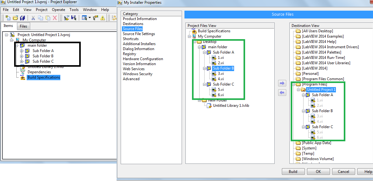

I guess this can be done, while creating installer....
while creating exe it's not applicable....
pls check by adding folder format under source file settings...
Message 6 of 12
(5,702 Views)
while creating Applicaption(EXE) folders can be added easy but creating Installer, I usally add them as autopoplating in project first and then add this autopopulated folders directly in build sructure. have look at this
Amit

Above picture representing installer rite?
Message 8 of 12
(5,673 Views)
yes 🙂
