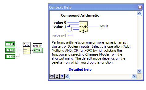

Thank you for your answer, but unfortunetly that wasn't what I'm looking for.
Im looking for something like this:
this being a rather crappy drawing of an and-port with 3 input terminals, and the terminals being visible.

It is exactly what you are looking for.

Look again at the picture posted above, it shows exactly what you need, the "compound arithmetic" node, found on the numeric and the boolean palette.
  1. Resize it to the desired numbers of inputs.
  2. right-click for the desired operation (AND, OR, XOR, etc.)
  3. right-click on each terminal to invert the particular input or output (shows as small circle).
