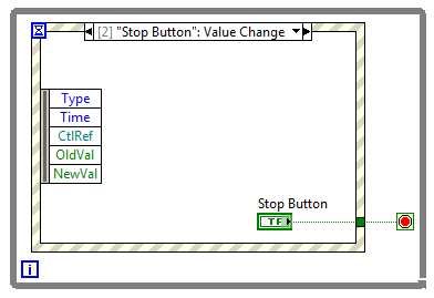

Hi miggins,
GerdW solution for pairing buttons will certainly do the job.  Be aware that you will not be able to use latching booleans with local variables.
A small point that I would recommend it that you also include an event that handles when you press the stop button and wire a value out of the event structure to control the loop.  This is because at present the loop will not stop when you press the stop button, rather it will wait until you press one of the booleans too as the event is waiting for that "value change".
This is what I mean:
Stop Event
