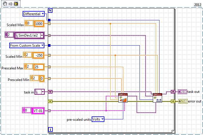

I have attached a snippet of my code - when I examined it in operation, only the last channel in the array is applied to the task with the final array scaling values.

When outputting the Virtual channel data from the For loop you are using the Last Value tunnel mode which will only output the last element in your array, you will want to change this to an auto indexing tunnel so that you can feed out each element with its scale applied.
Has this helped, or were you talking about the functionality of your "Linear Scale" subVI tht you have on your code snippet?

I am not sure what is happening in your customscaling.vi as you havent posted it.
I would create the custom scales first and apply it while the task is being created as below. You will need to adjust the values as necessary.

Hello Mark,
That was very helpful, thank you, it's so obvious now that you point it out.
The custom scale VI just has the new Linear scale vi in it, and a channel property node which applies the custom scale to the task.

Thanks for that suggestion, it looks like a simpler solution to the one I currently have.  I will give that a test with my code.
