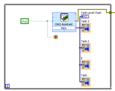

I want to connect 4 tank mimic to DAQ assistant with 4 current inputs.
But refer vi did i connect the tanks correctly to DAQ assistant? I dont know where to find the settings to assign say tank1 to current input1 and so on. I dont have the DAQ hardware to test my vi yet.

Split Signals on the Express/Signal Manipulation palette.
