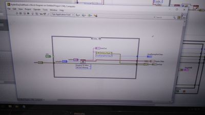

I can't share the code as I don't have access to it. Although, I can share the picture of it.
The above picture can help you out.

PFA

Hi Aditya,
so first you read samples from DAQmx, emptying the DAQmx-internal sample buffer, then you read the number of available samples.
And now you wonder why sometimes the buffer is reported empty AFTER you read the samples from the buffer!?

Usually when tasks run fine for quite a while and then suddenly cascade into a buffer overflow error, there are some bad coding practices to uncover and fix.  One example is an array that can grow without bound -- eventually it becomes time consuming to allocate new memory, and so the app gets stuck and doesn't call your DAQmx Read function as often as it needs to.
Over the long haul, it's necessary that your application retrieves data from the buffer (via calls to DAQmx Read) at the same AVERAGE rate as the hardware sample rate.  In the background, the DAQmx driver manages the process of pushing data *into* the buffer from the device., and that's getting pushed in, on AVERAGE, at the hardware sample rate as well.
Think of a boat with a slow leak. Water is constantly trickling into the boat at a regular rate.   This is like DAQmx pushing data into the buffer.  You're in the boat with a 5 gallon bucket.   Every once in a while, you scoop up a few gallons of accumulated water and dump it over the side.  If the leak flows in at 1/60 gallon per second then you need to dump water at a gallon per minute to keep up.   This is like your application.  You need to remove data from the buffer at the same average rate it's coming in, without every having a long enough idle period for the buffer to overflow (or the boat to sink).
