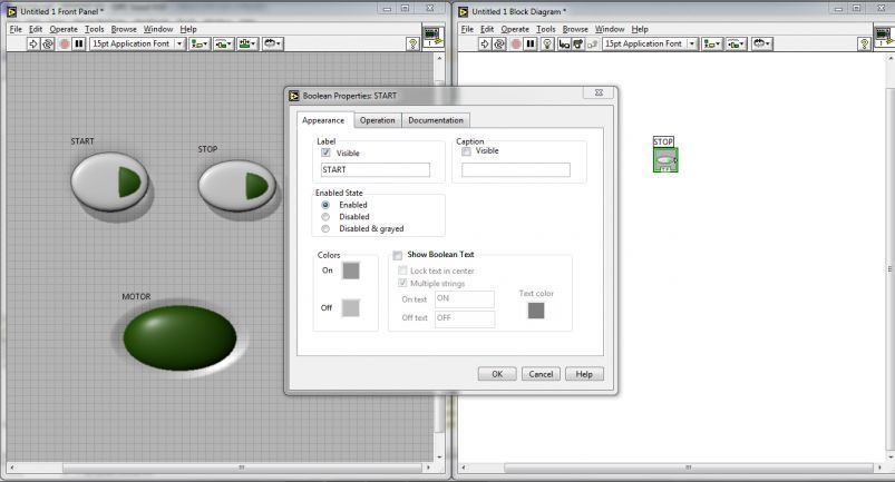

happy to join you, this is my first topic. Would you please tell me why I can't find data binding tab in my labview.

Size is also missing on the Appearance page.

please find attached the vi file as required.
please note also that the labview installed is 7.1

Hi yassine,
all three booleans show "Data binding" settings as well as their size parameters for me…
(Tested using LV2017 and LV2011SP1.)
What happens after restarting your computer, starting LabVIEW (which version do you use?), opening a new fresh VI, and placing new boolean controls? Can you set data binding now?
Message 5 of 13
(5,694 Views)
I am using labview 7.1 and I restart PC but i still have the same result.
Message 6 of 13
(5,689 Views)
There is no such tab in LV 7.1. If you want to bind to DataSocket, you need to go through the Data Operations context menu, then click DataSocket Connection...
