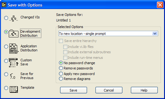

They still have no diagrams. this is something you can verify yourself. Just open one of the VIs and try to go to the block diagram. If you are creating this llb from separate VIs, how are you doing it? You should just be using the Save With Options>Development Distribution. DO NOT select Application Distribution. As you can see by the options for this, it automatically removes diagrams.

Whatever you are doing, you keep repeating the same mistake. You screen should look something like this. Delete any old llb of the same name and try again. Before posting, actually look at what you have created. If you can go to a VI's diagram, then it's okay.
