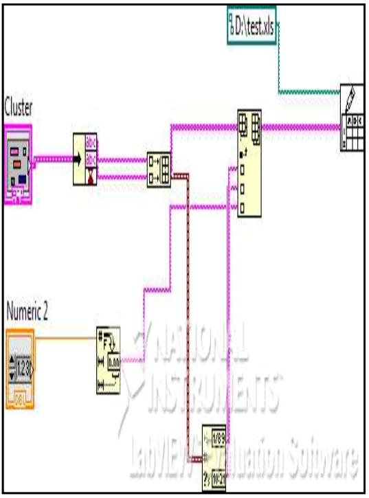

i found this from the internet.this is for data save to excel.the problem is i dont really understand this diagram.because i have to save my data to excel. i google the solution already but most ot them i cannot understand. can u please explain to me about this diagram?
tq
